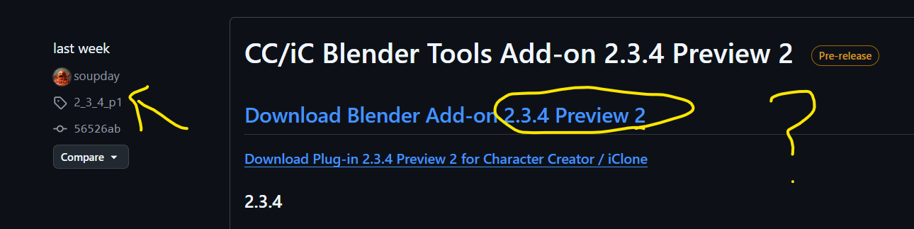

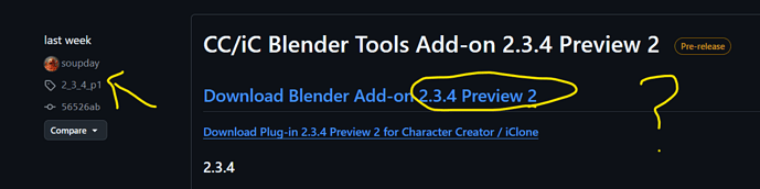

When I try to install 2.3.4 Preview 2 to Blender 4.5, I get a “missing manifest” error message. I’d use 2.3.3 but the plugin the Hub installed to CC5 wants 2.3.4. I feel like I’m missing a step somewhere, despite watching all the videos and reading the manual.
Also, the file name when I download 2.3.4 Preview 2 actually says Preview 1. Maybe that’s the issue?

Missing manifest usually means you are trying to install the plug-in meant for Character Creator / iClone into Blender.
That worked! Thank you!!
