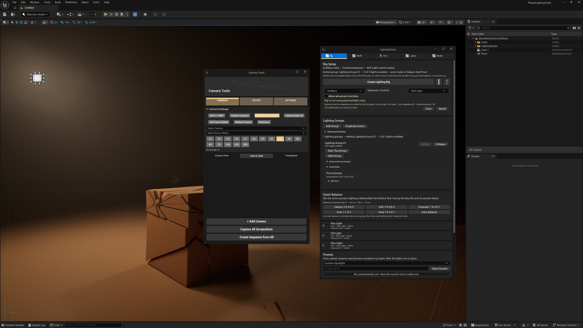

Here is my C++ project where I am developing two UE plugins, you can clearly see the RLPlugin icon in the bar.
