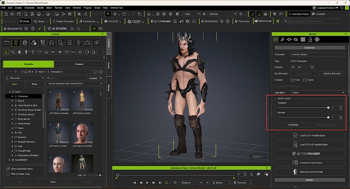

Hi Cary_B,
We noticed that your file contains SubD Level 1 (See Image1), which should not be present in a character created with CC4. Could you kindly provide a screen recording showing how you created the character? This will help us understand why it is being recognized as a CC5 character rather than a CC4 character.
Thanks!
