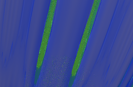

I wouldnt know where else to ask. I am currently experimenting alittle with Mandelbulb3D. There is one issue i cant solve which are black pixels in the images no matter how high i render it resolutionwise. This is part of a 4k render. Anyone knows how to get rid of those black pixels ? They ruin almost every image created with that software ![]()

The rays might be overstepping the boundaries of the fractal. Try lowering the Raystep size.
I ended up in the ray settings but no matter what i try i cant get rid of those dots. I notice a change when using different settings, but they are always there. One way i could think of was to render a 8 oder 16k image and scale that down. But that would take beetween 5 and 20 hours to render … just for a test …
What are your settings? I’m pretty sure it’s a problem in your settings.

I changed all the corresponding ray values up and down , used different combinations, but like said with only a little change. Scaling is out of question because i need that sharpness on the egdes. I need to render at 4k minimum. because i make a mesh from it and want to zoom in. you can imagine when making a terrain for example how difficult that is sharpness weise.
BTW those pixels do not appear on evrery fratcal type , perhaps its part of the formular itself ?
EDIT:
I just rendered a few other formulas in “high” calculation mode, it appears that those dots only depend on the formula…
