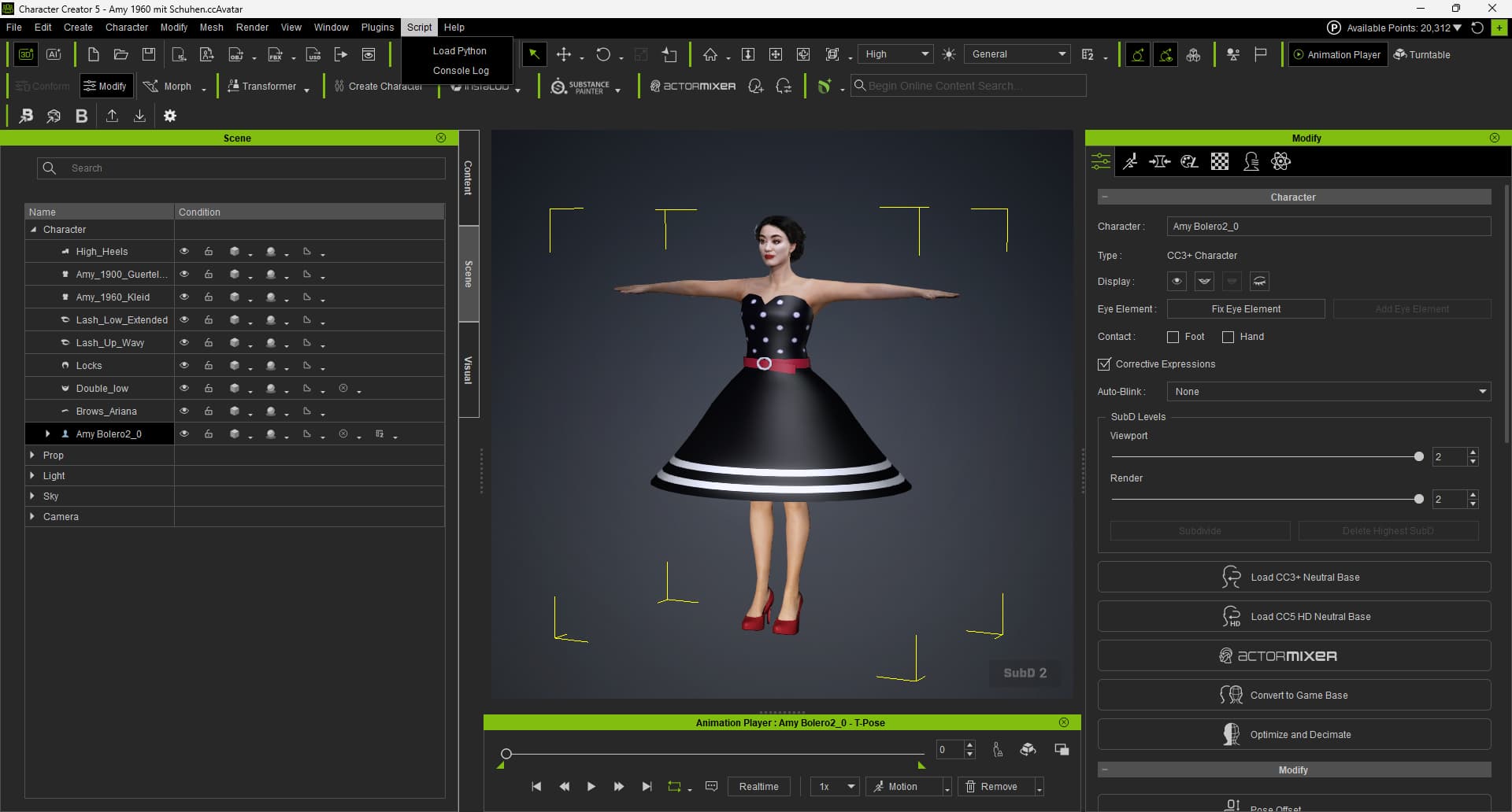

Amy is already on her way. She’s a CC5+ character. She’s still struggling with her wide skirt.
After yesterday’s update, it’s become more difficult. Whenever I rotate the view, I have to let the animation run 2 or 3 times before the skirt falls correctly again. If I stop the animation, the physics seem to suddenly turn off and the skirt jumps to a new position. It only stays in place at the very end. This is annoying because you can’t render photos in the middle of the animation.
If you have any tips on how to prevent this, please let me know.

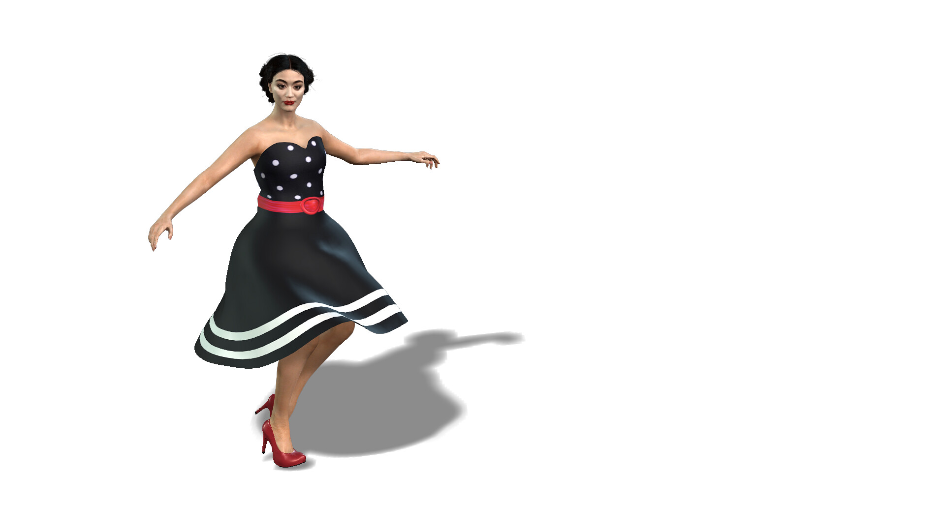

thanks, bake animation has worked. I have set it in the project properties and activated the frame by frame calculation. After switching of the physics, it has worked well.

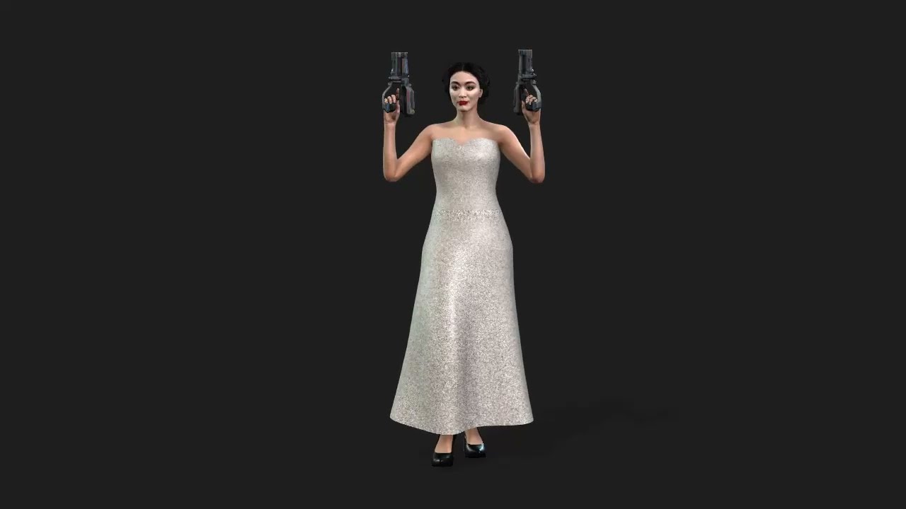

Now Amy wanted a long dress, too, and the struggle with the skirts continued. But at least she’s doing pretty well.
