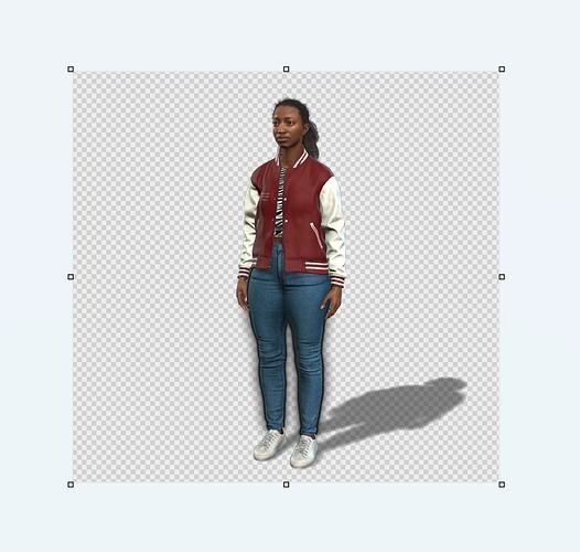

I just ran a quick test and my Sequence Image PNG’s all had an alpha channel as can be seen below.
To check this on your system, just load a single character into a new empty project. Confirm in Project Settings (CTRL+SHIFT+P) that you have no 2D Background active, and then render to Sequence PNG. You should then get the same result as in my test.
