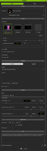

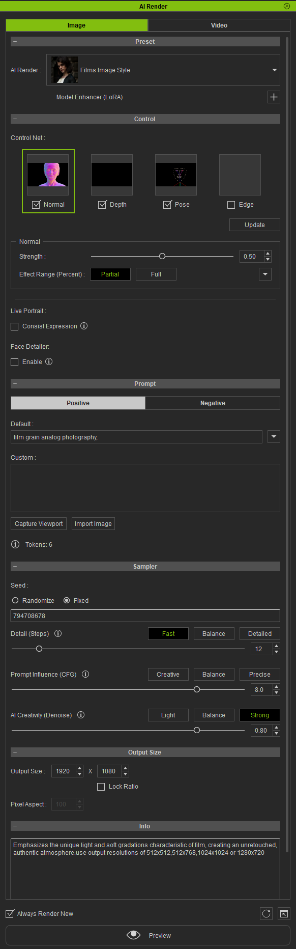

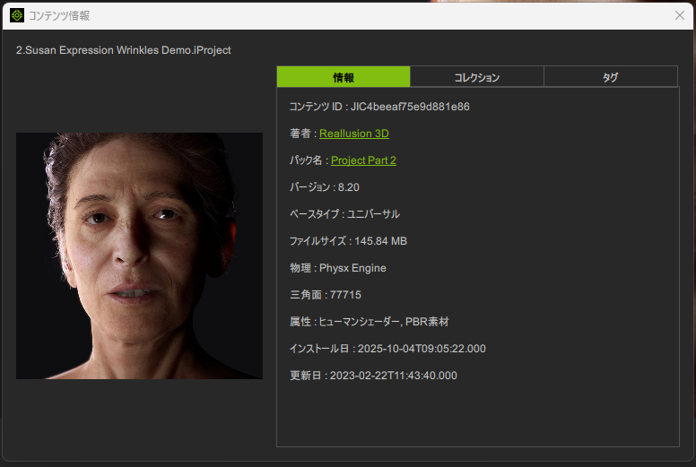

While rendering a still image with AI Render, it appears to enter an infinite loop and never finishes. The project is the attached file with 309 frames.
