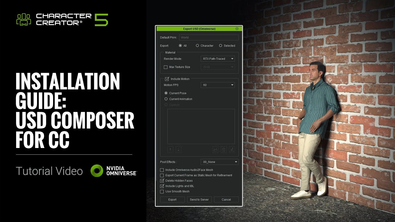

I was using Omniverse up until October 2025 when they stopped supporting the Launcher - if there is a way to use it now, I cannot figure it out and I cannot find any tutorials for how to do it after October 2025.
I understand now what you are saying about AI Render not being a true representation but there is a tutorial that came out early on in the beta that showed a render of a low poly man in a suit and the render just looked like an upscale version but it was clear that it was the same man. Everything was just a bit more refined but again, I cannot figure out how that was done as the interface looks different now…and I cannot find a tutorial for current version that demonstrates this.
Have a look here.
You do not actually need the sever part that it mentions if you are just using USD files you save from CC or iC.
