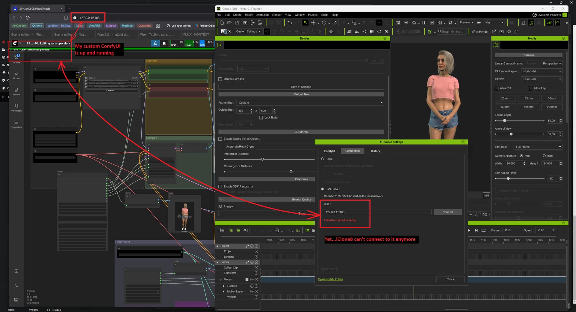

I’m giving a try to the AI Render plugin for iClone8.
I configured everything and it worked properly. I managed to render some images by using a custom workflow (on a custom ComfyUI installation) ==> ok
However, after restarting iClone, it can’t connect anymore to my ComfyUI server:
What’s wrong ? What can I do ?
Are there some logs I can browse to understand the issue ?
Many thanks for your help

  1. Actually, I don’t know how to access the console log. How can I do that ?
  2. I’m using my own ComfyUI installation I used before installing iClone. All of these are on the same computer.

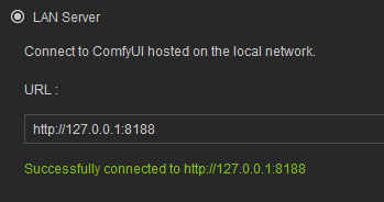

Actually, I managed to get through this by simply adding http:// before the local @IP and it work nicely:
Thank you for your help
