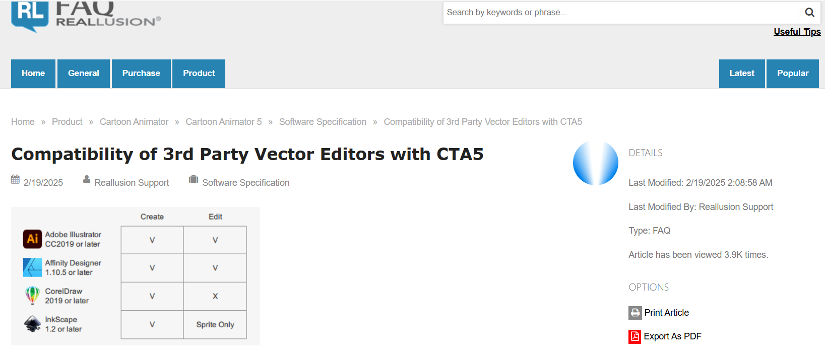

Hello all, would like to know when CTA 5 will have update for edit vector in affinity as we can see on Faq page.

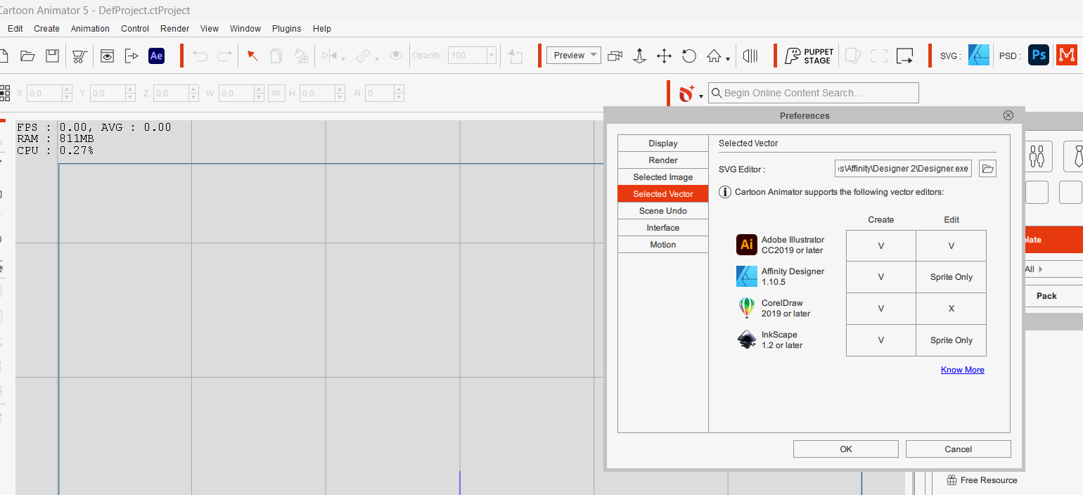

yeah, i note that. But im talkink about inside CTA 5, when you go to preferences, we only have illustrator edit option as the picture

Actually we have an Affinity Pipeline update coming in version 5.33 of Cartoon Animator. This is currently scheduled for release before the end of the month.
Once version 5.33 is released you should find using Affinity Designer with Cartoon Animator will be much improved as it will allow editing of SVG full bodied characters.
