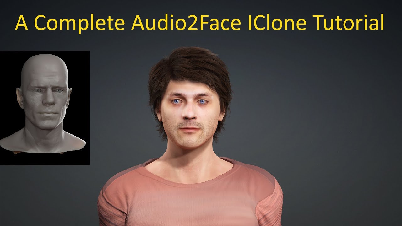

I find Audio 2 Face easy. It works with all languages also, although I have only used it for English.

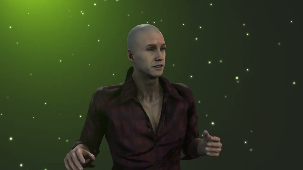

I redid what 4u2ges did. I used Google AI Studio to transcribe the audio into text. Very accurate. And ChatGpt to transcribe into English phoneme. The result is not too bad but the “ou” “on” “o” sounds lack precision. In these 2 examples, it is my voice that went through the w-okada voice changer. I used Epic game’s live link for facial mocap and mocopi for motion capture on the same iPhone 12 mini. Both applications can run at the same time. In this exemple Kevin talking is more accurate because there’s more facial blendshape than the Daz Mervin character.
