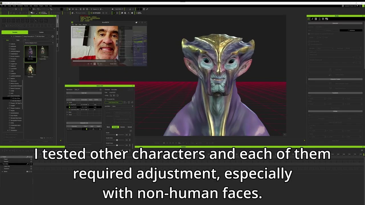

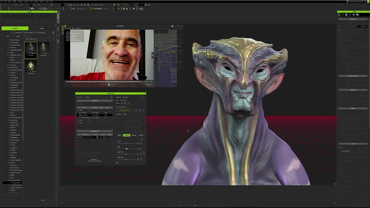

Before contacting support , I would like to know if it is an issue only on my system or not. Have a look on this video :

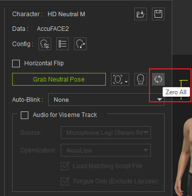

As for the issue where the character’s mouth won’t open fully, I suspect it’s caused by the active Grab Neutral Pose. Based on your video, the current active Neutral Pose was captured using values from the demo video’s female actor. Once you switch the video source, that Neutral Pose is no longer suitable, so you’ll need to clear it or perform a new Grab.
Please feel free to reach out if you run into any other issues. Thanks!
Hi Raytsao and thank very much for your answer. It helps me. I get satifying result. I made a video of what Idid. I didn’t find a user manual of accuface2 to go deeper .
