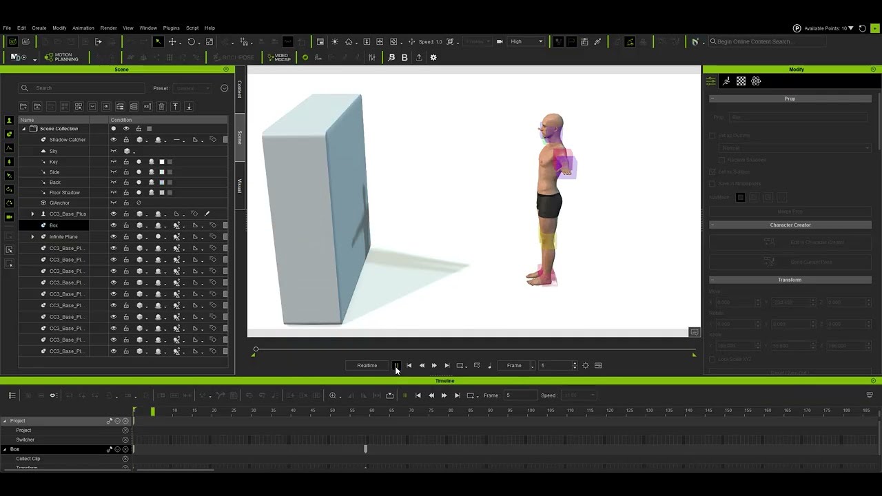

There were some tricks on how to achieve this, for example by using reach targets and placing invisible spheres at the hands and feet and then giving the spheres a physics animation.
Can you do whole breakthrough and process how to achieve this! I’m noob to this!
@Stridgamer Here is a description how to open the Reach Target panel. Using the Reach Target Panel You can select objects and add them as a target to head, elbows, hands, hip, knees and feet. The bodypart will then point to the object. For example, use spheres as an object.
iClone then has a rigid body physics system. With it you can animate the spheres like described here: The Rigid Body Simulation If you start the animation, the character should follow the movement.

Here is the basic idea of using the reach targets for a rag doll effect.
Thank you for this video Rampa!

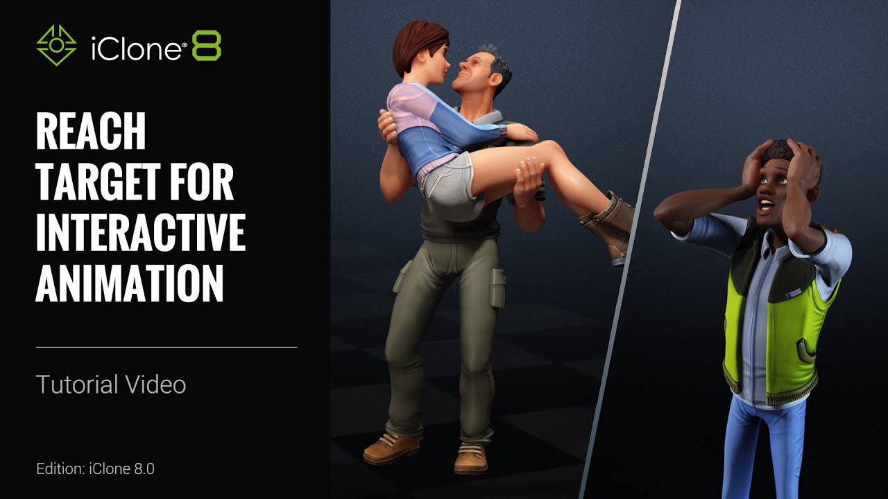

Is it possible to achieve the same result for carry a character who is a sleep stuff like that?!
Try 4:40 in this video.
Sorry for late reply, Rampa! Well not exactly what I meant! Like a person is asleep and over her or his shoulder!
Like carrying a person over the shoulder area!
