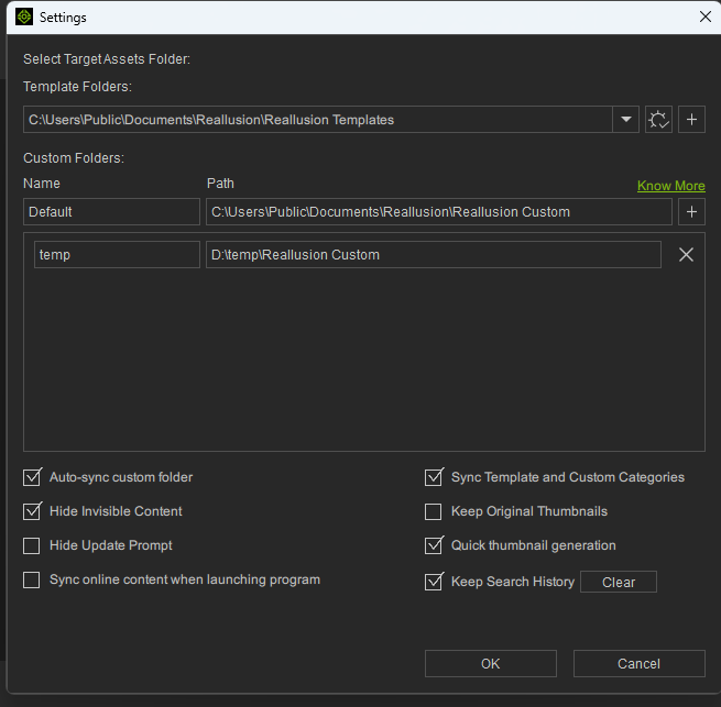

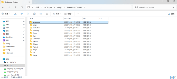

Ideally, you should add the new path through Settings. Once added, the categories within that folder will appear automatically. Please refer to Images 1 and 2.

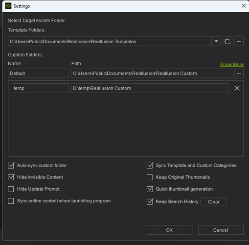

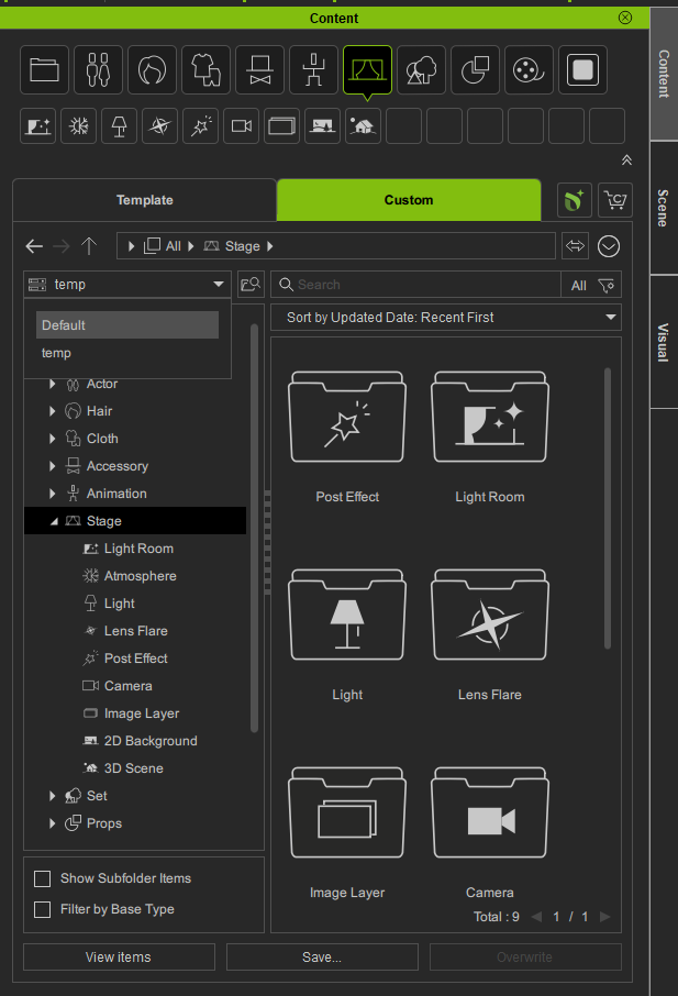

You can then switch between the two folders using the drop-down menu above the category list. Please refer to Image 3.
