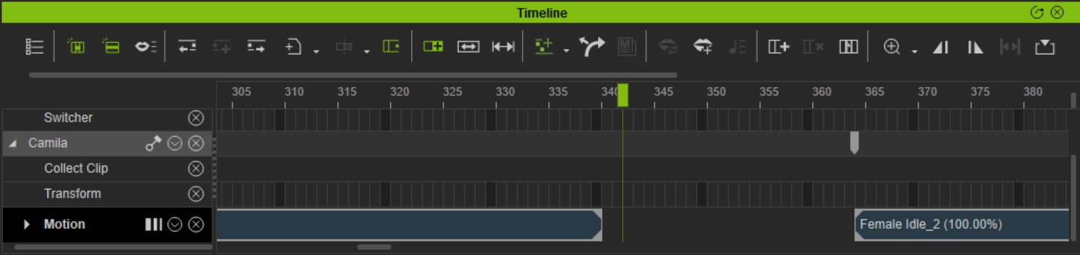

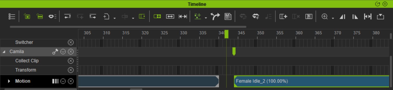

The first screenshot below shows two motion clips with the Play Bar in-between them. The second screenshot shows the two motion clips after inserting 20 frames with the second motion clip starting 20 frames later than originally.
So if you try this simple test are you still finding the inserted frames are added at frame 1 and not at the point of the Play Bar?
