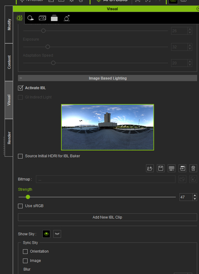

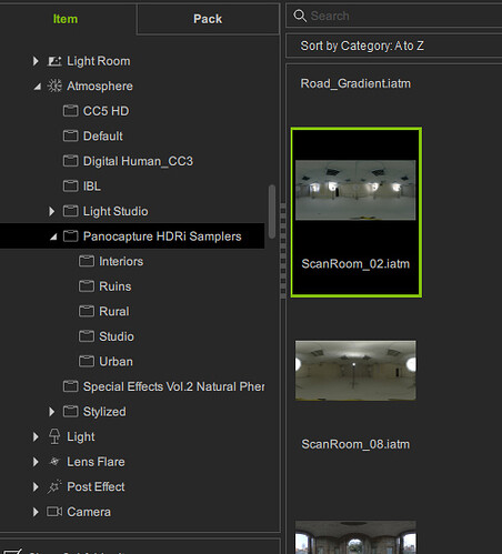

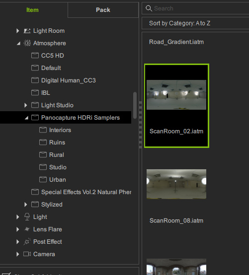

Directly usable content from that pack is in Atmosphere > Panocapture HDRi Samplers:
Those are .iatm which usually override current set of lights, visual settings and IBL.
.hdr files (which part of the .iatm) are set into IBL channel.

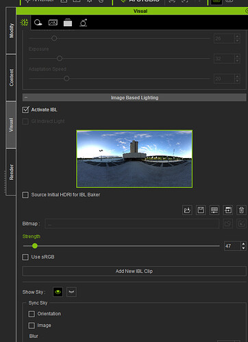

If you would like to use .hdr files individually (without changing current lights and other settings), you have to drag and drop them from Windows Explorer directly into IBL channel. Or click Load from IBL section and pick any .hdr file from there:
When .hdr is loaded into IBL, it also loaded into the Sky texture. That is why you see it in the scene directly. You may enable, disable the sky from IBL and also sync sky orientation with the light from IBL.
Finally if you drag the .hdr to the viewport, it would set as a Sky, but not as IBL.
