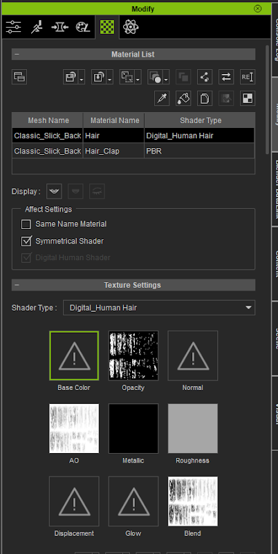

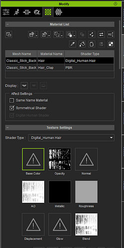

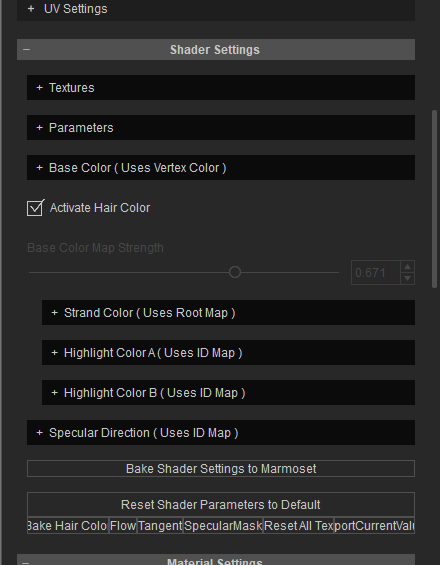

This might be caused by some specific steps—mainly because CC5 hair color might not be assigned using a texture map (check the Content settings). If possible, could you provide us with a Blender material node graph, as well as your original imported character FBX or CC project?
Some materials do not use a diffuse map, while others achieve their appearance through shader parameters.
For example, in this case, the diffuse map is empty, and the color is created through the shader settings. Our Auto Setup will transfer these parameters to the external software. (See Image)
Thus, we would like to ask for your updated material node graph so we can determine why the hair has no color. If you modified the shader node connections manually, you may have overlooked that the hair does not necessarily use a texture. Instead, certain parameters or nodes may need to be configured correctly.
