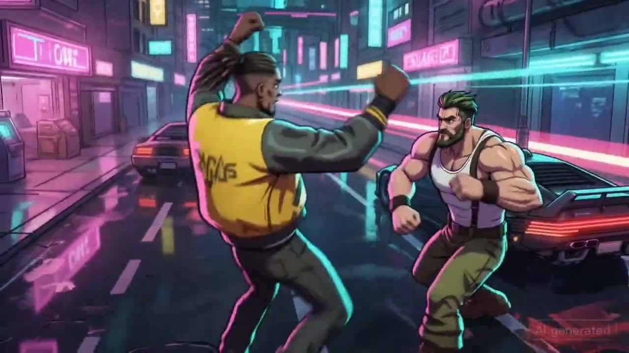

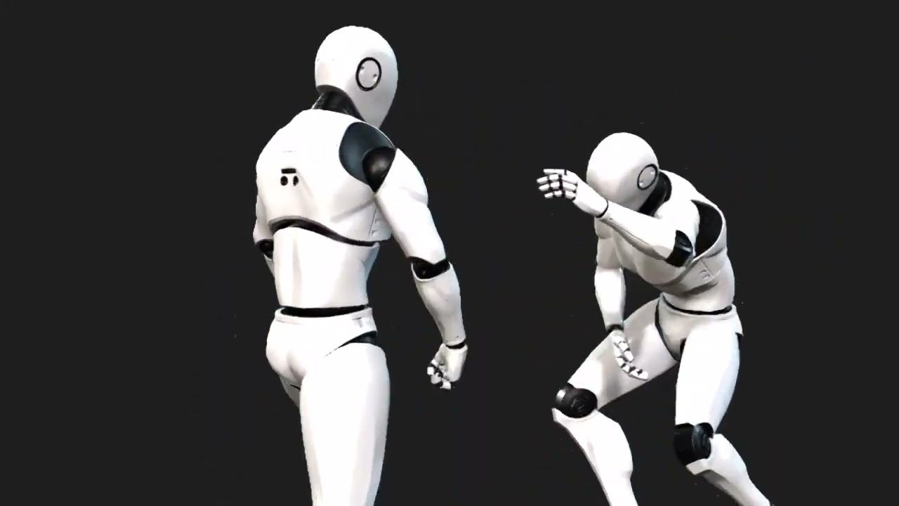

  • Answer: Style is entirely determined during the initial Image Generation phase. Because the video generation pipeline builds directly upon that generated image as a foundational reference, the style carries over automatically. There is no need to select it a second time.
▲ The first frame image determines the style of the video
▲ The 3D animation sequence inputs spatial and motion reference
▲ The video model follows the style of the reference image (First frame image)

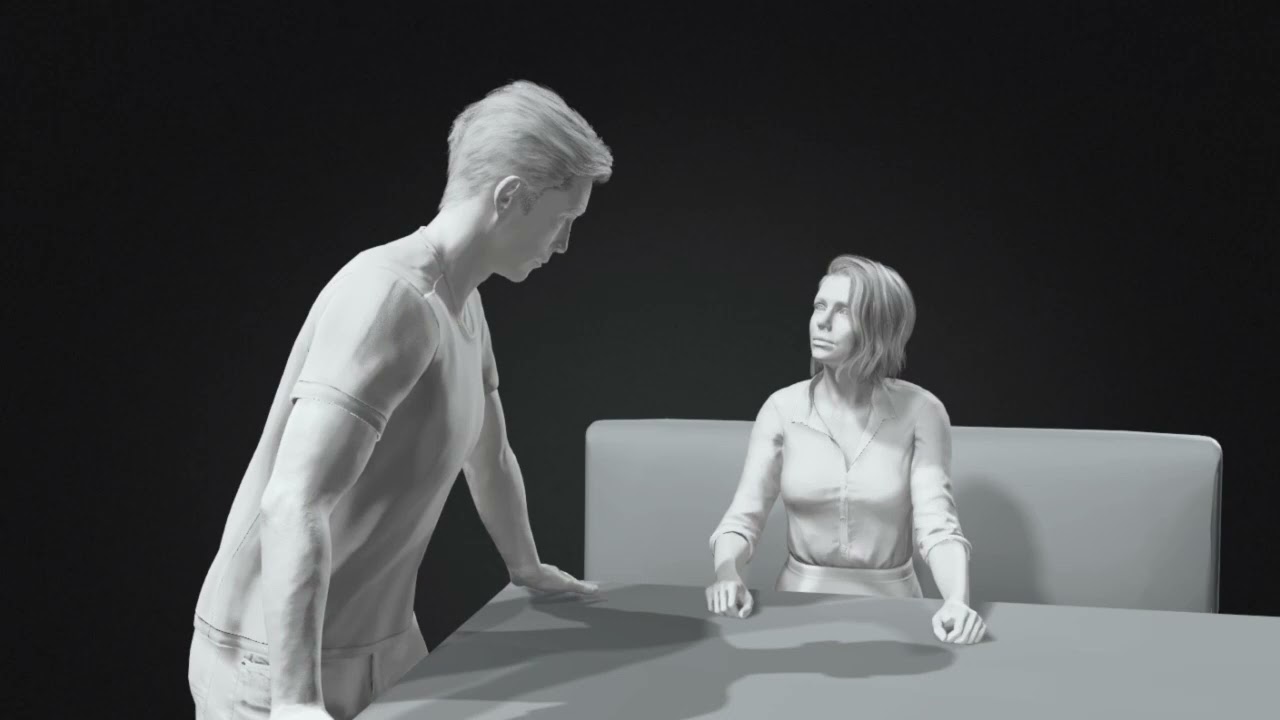

Q2: Why are camera technique presets unavailable in 3D-guided generation?
  • Answer: When a 3D camera reference is already active, adding a separate camera text prompt becomes completely redundant. Doing so will only confuse the video model and produce unexpected visual glitches.
:movie_camera: The Rule: 3D-guided generation will inherently respect the camera settings, angles, and movements you have set up within your iClone 3D environment.
▲ 3D animation sequence with camera movement

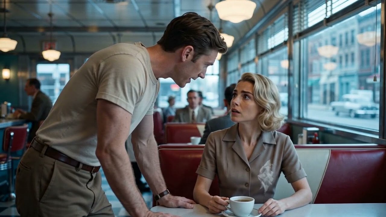

Prompt:
A dramatic cinematic scene of a tense exchange between a man and a woman sitting at a table. The man has a cold and guarded demeanor with visible muscular tension, a clenched jaw, and a furrowed brow conveying suppressed frustration. Maintaining sharp, piercing eye contact with rigid posture, his lips barely part as he leans heavily on the table, his voice dropped to a barely audible whisper: “I’ve got word on Jack. He’s still alive.” The woman is anxious, breathless, and struck by sudden disbelief. Her eyes widen, pupils searching his face for any sign of a lie, as a fleeting flicker of hurt and profound sadness crosses her features. Her shoulders are tensed, holding her breath in a moment of emotional suspension, her eyes flickering with a mix of hope and pain as she says: “Can you help me find him?” Shot in a realistic movie style.
▲ The AI rendered video follows the 3D camera settings, and add subtle details through prompt
