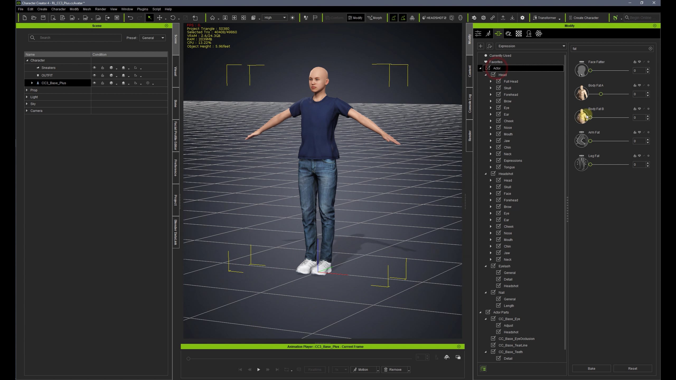

Meantime, if you have an iClone you can easily transfer CC slider morphs into exportable morph in Morphs Creator.
If you do NOT have iClone, things are getting more complicated and cumbersome. But you may still create exportable morphs for clothed characters with the help of Blender Pipeline.
The end result character can be animated with a morph inside Blender. I assume it should also work in Unity.
Note: morphs slider converted to exportable version CANNOT have bones scaling involved. Those will not work right inside the target app. Also this routine is sort of experimental and might not work right in all scenarios.
Here is a quick demo I put together for making exportable morphs in CC from Fat_B slider without using an iClone. Blender Pipeline is a must for creating link-able cloth morphs and testing the outcome (funny that you may not fully test the outcome inside CC - only by exporting FBX and importing into target app)
