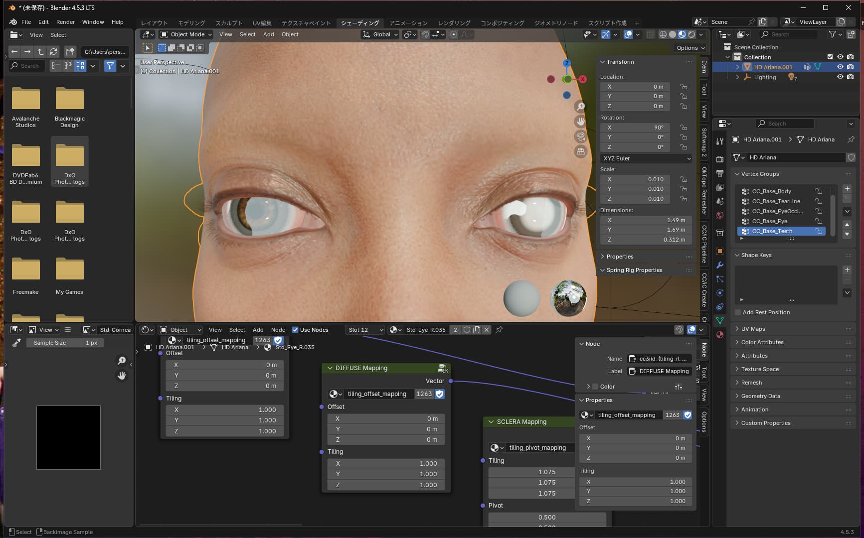

Datalink to Blender, the eyes turn white — ray tracing doesn’t fix it.(CC5 Blender4.5 Pipeline2.3.2 /10th core i5/win11/rtx5060 ti 16G)
In CC5, I sent CC4 Camila from CC5 Characters in the Content Manager to Blender using Send Morph.
Unfortunately, Camila was not transferred correctly — her eyes turned completely white. It instantly became a scene straight out of The Walking Dead.
I saw a topic suggesting that turning on ray tracing would fix the white eyes, but it didn’t work.
To fix it, I had to go into Shading and set all the Tiling values of the Diffuse Mapping to 0.
The image shows the state where only the right eye has been fixed.
The current issue is with the right half of the right eye — the reflection looks wrong.

Hi Daisuke_F,
The reason this happens is that Send Morph is primarily designed for morph usage, which transmits data back and forth using OBJ format. Therefore, this feature currently does not include complete materials, resulting in the character appearing with white eyes.
If you need the full functionality, please use Send Avatar instead.
