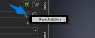

Sounds like it is installed, just not showing up in the Content Manager. Try these steps:
  1. Reset the content metadata by right-clicking the refresh button and selecting “Reset MetaData”.

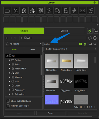

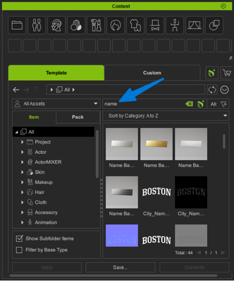

  2. Search in the both the pack and item tab. Choose the “All” category and type the name, or part of the name, into the search box.

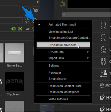

After running the database reset, select “Sync Installed Content” from the Content Manager drop-down menu to quickly relink all your thumbnails to their content, if they have turned gray (it’s a regular left-click on the menu button).

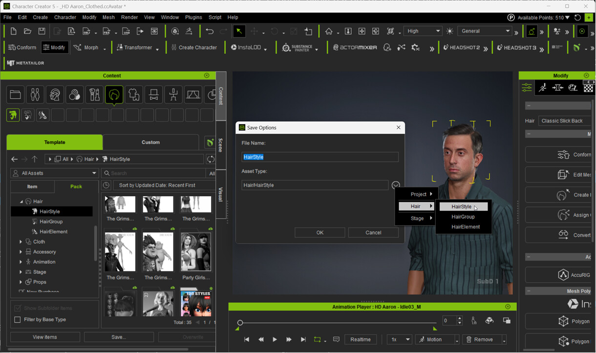

Any component of your character can be saved separately in the Content Manager. So if want to save the hair from a character:
  1. Select the hair in the scene. Double-click it so there selection marks around it. As a single click usually just selects the entire character.
  2. Select the Hair category in the Content Manager.
  3. Click Save at the bottom. It will be saved in the same category in the Custom tab.
Have a look at this Content Manager tutorial:
Always make sure you are in the right category. You may find that you saved a character when you meant to save just some element of the character. You do get a second option to set the category after clicking Save as well. So two ways to make sure you are saving what you expect. :slight_smile:
