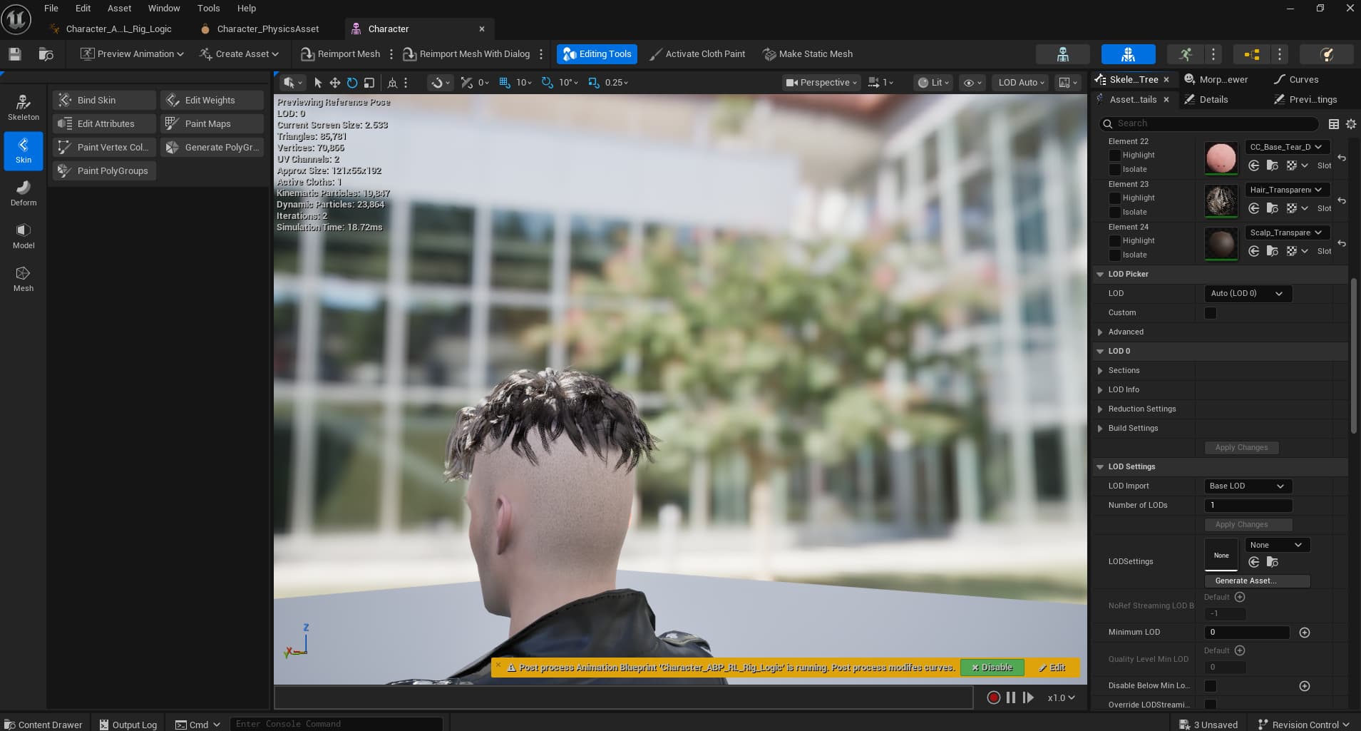

Hi @Freshness34,
Could you screen-record your workflow for us to investigate further? We tried using 2.02 and replacing it with 2.03, your character’s hair didn’t turn grey
Did you by accidentally move or delete anything inside the CC_Shaders?
Could you also screenshot the Hair materials in the Skeletal Mesh as a reference image below
Thank you

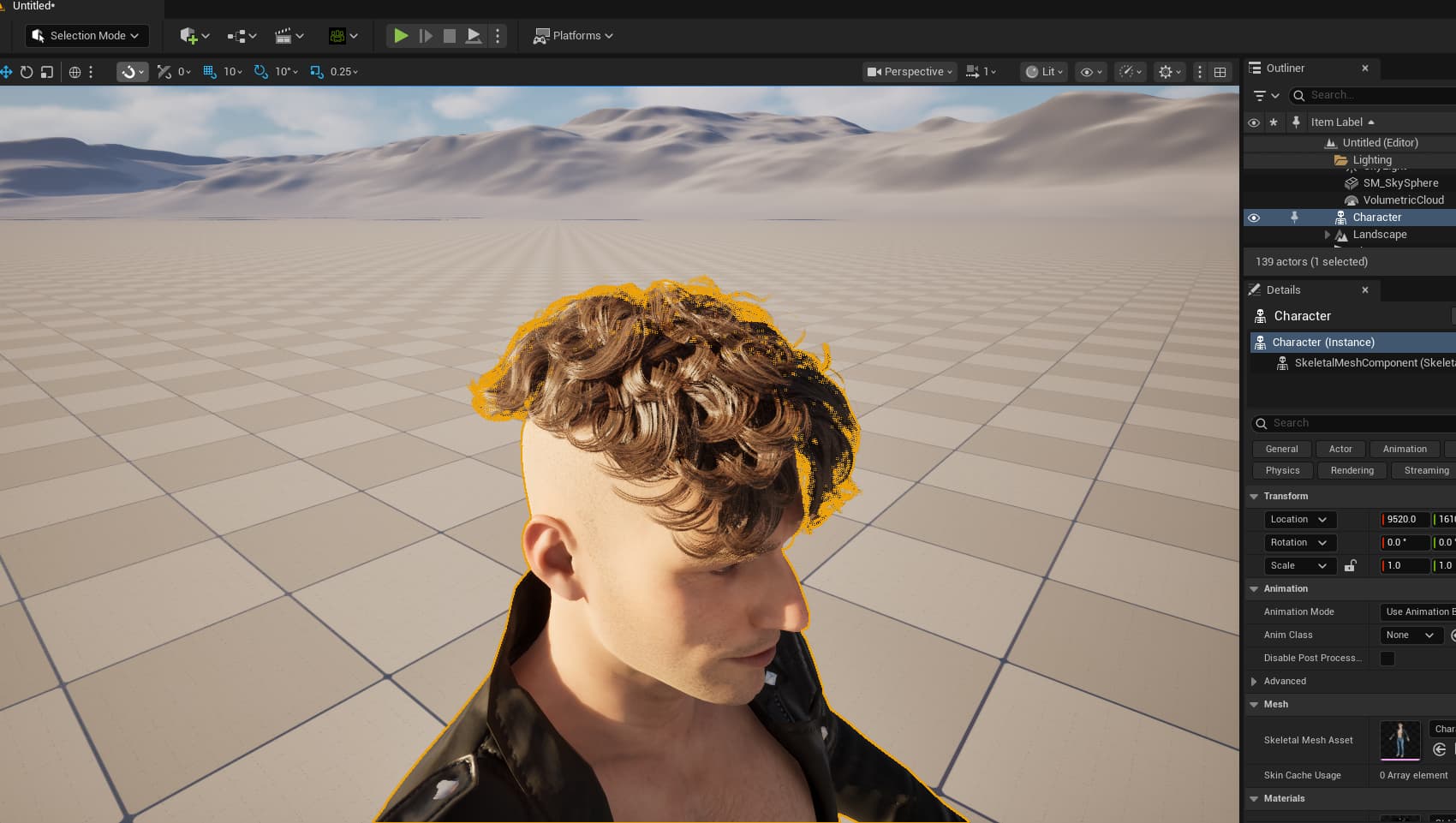

@Winner_RL ,
After upgrading to AS 2.02->2.03, I immediately started a playthrough and the textures for the characters were still grey/texture-less (the characters were already animated via an animation blueprint containing animation sequences.) When I then opened the SKM file for each character, the textures were properly assigned and were no longer grey. I went through each pre-existing (<= AS 2.02) character and opened their SKM files where I noticed the textures were properly assigned.
Ultimately, when I closed and re-opened UE, the issue went away. Each character had already been assigned animation blueprints and the animation sequences within I believe were pointing to cached versions of SKM/preview mesh. I also noticed that, within each animation sequence, in the Asset Details window, the source file was pointing to an .fbx file in the windows temp folder. I cleared those values also, then closed and restarted UE and the issue was resolved.
If the developer has existing characters already assigned with animation blueprints/sequences, UE caches the source file and, even after updating Auto Setup properly, the animations will still point to an earlier version of the SKM.
Rather long-winded, but that’s what I believe was going on in my case.
