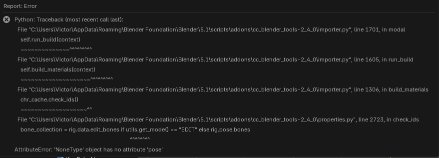

I would also like to report another issue. Every time I import an FBX using Pipeline, a red error message appears at the bottom of the screen. It does not seem to be a serious problem because the ā€œAll Doneā€ message appears immediately afterward and the import process completes successfully.
Issue Pipeline 01

I have also encountered a similar issue with a particular character FBX. The same red error message appears first, followed by another message showing additional errors. Despite these warnings, the character appears to function correctly and I can work with it without any noticeable problems.
However, I am concerned that these errors could become more problematic with future Blender releases and potentially affect the addon’s functionality. I hope you can identify the cause of these messages and provide a solution.

Any traceback errors like this are a serious problem. They mean it crashed unexpectedly and didn’t finish what it was doing.
But that particular error, on it’s own it doesn’t make much sense, unless something caused another error before that.
What are the exact steps to reproduce this error:
  • How did you export the character.
  • What steps did you take to import the character into Blender.
Hi! I found the issue, and it turns out it wasn’t a problem with the add-on after all.
I realized that I had accidentally saved a custom startup file (ā€œSave Startup Fileā€) in Blender with one of my characters already loaded in the background. Because of this, every time I opened Blender and tried to import a new character, it caused a conflict with the existing one and triggered the error. In fact, when I tried to import that same character that was already loaded, it would trigger even more errors.
I have now loaded the factory settings to have a clean startup scene, and the importer works perfectly. Sorry for the confusion, and thank you for your time!
