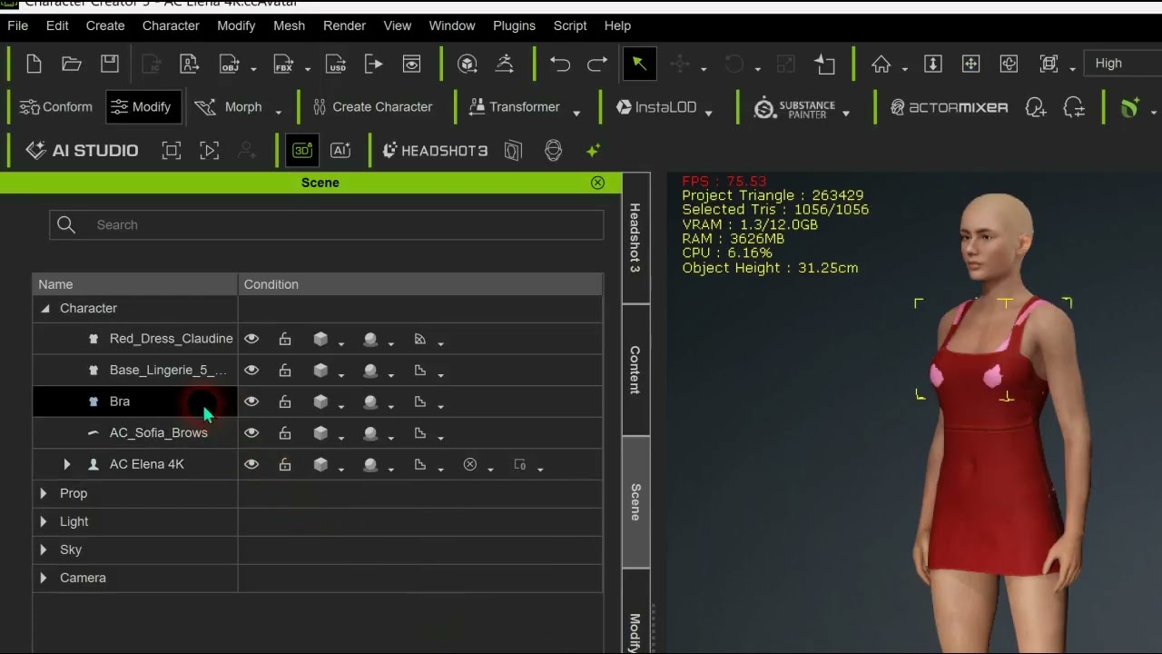

Anyone sees panel switch in CC when an item is deleted from Scene
Recently, I see that in CC4 (4.12) and CC5 (5.12) has this.
Load a character with some clothing or accessory. Under Scene, delete one item (e.g. a bra), the Scene panel will lose focus and switch to another panel, e.g. Modify.
All the Windows (content, scene, modify…) are contained in the same container on the LHS.
Anyone seeing that! (Mp4 Video Youtube link below)
Customer support said he did not see that!
I just tried this in CC4 and can confirm that this happens with the Modify panel on the LHS. However, when the Modify panel is on the RHS (as I usually have it), the Scene panel stays selected. (That’s why I never noticed it.)
Hi clonechiklo,
Thank you for bringing the snapping window issue to our attention. We were able to reproduce it after deleting a mesh from the character or scene.
We will report this issue to our development team for further investigation and keep you updated on any progress.
