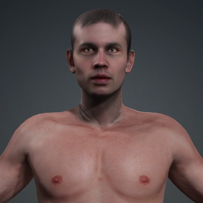

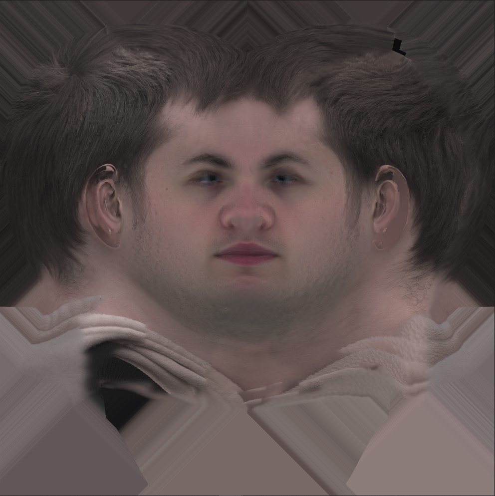

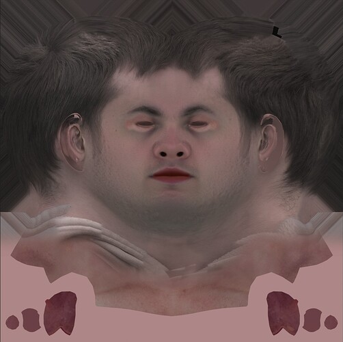

  1. The skin colour of the face and neck does not match the body.

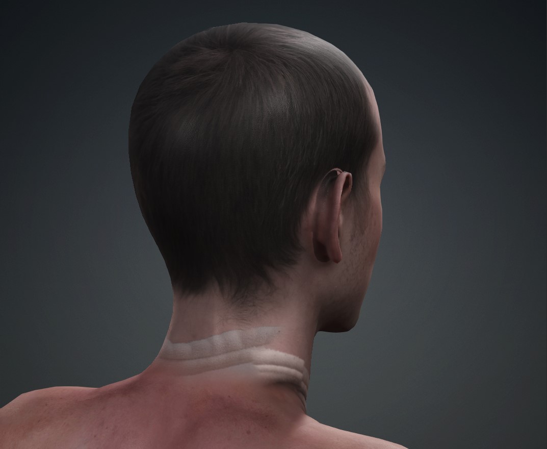

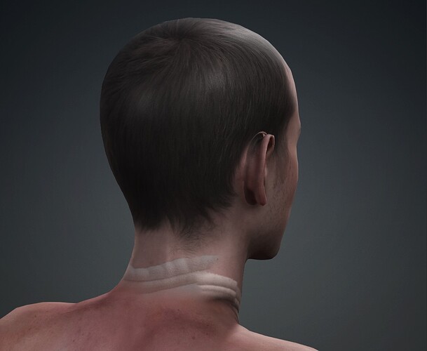

  2. The skin on the neck has artefacts from the original face photos.

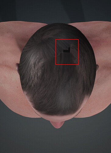

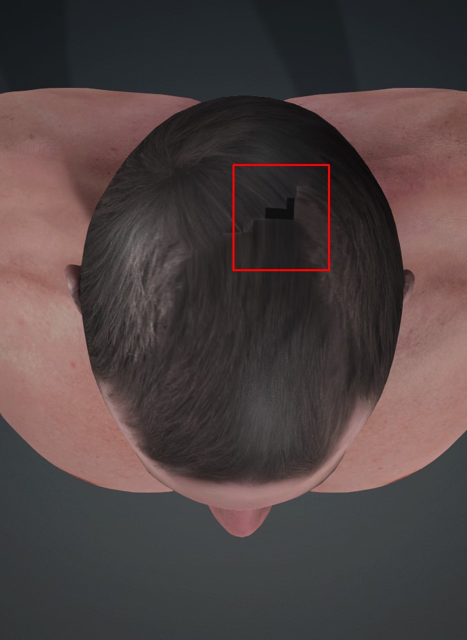

  3. There’s a missing patch on top of the head.

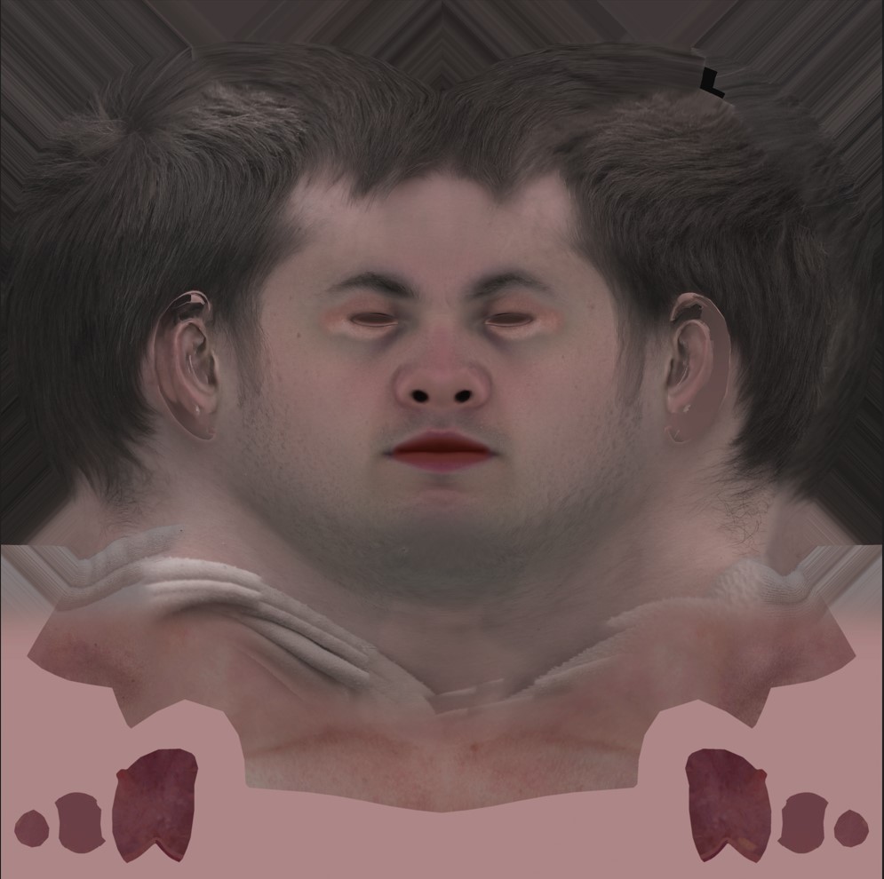

I have attached 2 screenshots of the Photo Diffuse in the Headshot tool and the Material (Std_Skin_Head).
Thanks in advance for your help. If you can’t help but know a place or a person who can help me, please direct me there.

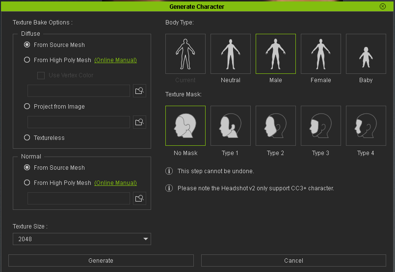

This shouldnt happen, have you used Diffuse from Source Mesh when attaching to a body ?
Use Mask Type 1,2,3 or 4 for a test.
i could imagine if you use Project from Image and “No Mask” this could happen. Not shure.
That little black hole, are you shure the source mesh didnt have that already ? Not shure what happens if the source mesh had that already. Looks like some missing faces. Thats easy to fix though, just edit the diffuse map in photoshop and use a stamp to copy a few pixels from the sourounding hair onto that hole.
