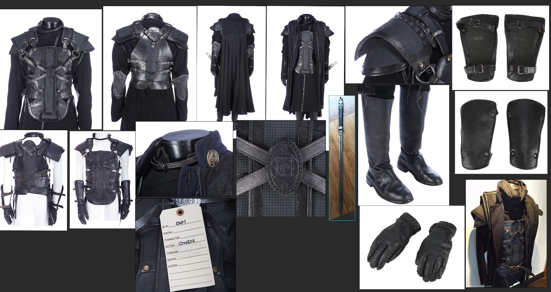

The Clothing: I am going to create completely new clothing and armor from scratch using Marvelous Designer and ZBrush and maya.
Final Render: I will bring everything into the Reallusion ecosystem to prepare for the final presentation. I am still deciding whether to do the final renders in CC5 or UE5.7.
Here are my movie references and my current portrait progress.

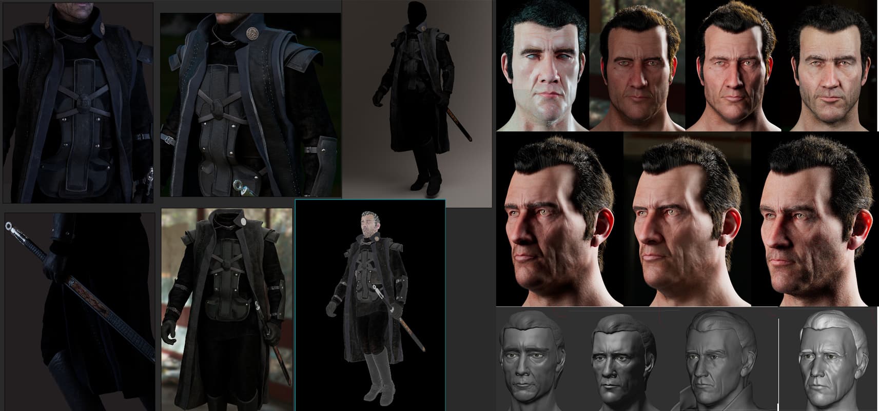

Below is a compilation tracking the original development of the character from three years ago, showing how I finalized the portrait likeness and blocked out the clothing in a static walking pose. I never posted this version on ArtStation because of that baked-in pose. I am holding back the final look of the head sculpt for my next update, where I will showcase the transition as I wrap it onto the neutral CC4 base mesh

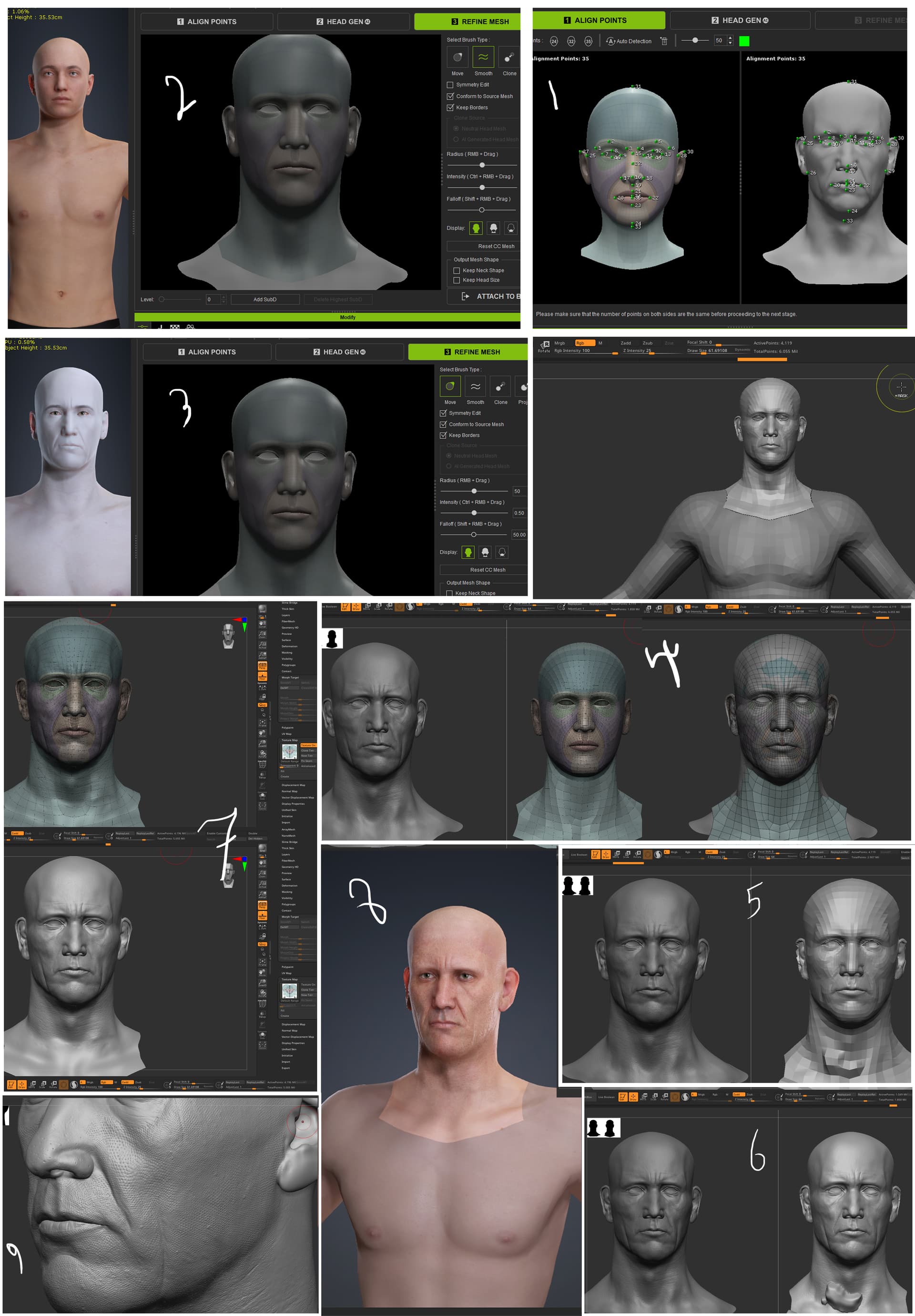

Update: CC5 Headshot 3 to Zbrush projection workflow
Hi everyone,
I have successfully transitioned the original Clive Owen sculpt into CC5 mesh using Headshot 3, projection, and clean-up pipeline in ZBrush
Here is the step breakdown of the image sheet:
1 - 3 (CC5 Headshot 3) Set up the alignment points on the facial features to generate the initial wrapped mesh
4 (Goz to Zbrush) Sent the mesh over to Zbrush to prepare the topology before hitting the projection button
5 (low poly projection) Projected the likeness details onto the low poly CC5 head mesh at a base resolution
6 (High poly projection) subdivided and projected the details onto a higher poly
7 (Mesh Clean up) cleaned up the topology stretching, and pose distortions caused by the old asymmetrical model.
8(Back to CC5): Sent the clean Low poly projedted head back to CC5 to verify the seamless neck blending
9 (Close up Hand-sculpted pore detail ) Close up look at final skin details. All pores fine wrinkles and secondar micro textures were sculpted entirely by hand in zbrush , no scan data or ready made paps were used. And honestly, this is the last time I am ever doing this by hand! :joy:
The character is now 100% rigged, symmetrical, and production-ready in CC5
Next up: I have already started blocking out the clothes. Let’s keep moving
